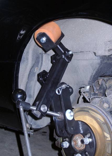

You shouldn't do it, if you are not a professional. Ask a garage or something to do that. Many garages do that. You need a special tool to tune the wheelhouse. I found some pictures, that might help me explaining it.
The tool is as mounted as the wheel as you can see. There is a kind of arm that crimps the inner part of the wheelhouse a little bit to the inside of the wheelhouse.
I'll draw a little bit ^^ I think it's understandable.
Hehe, I don't understand 100% but thanx for the pics:D

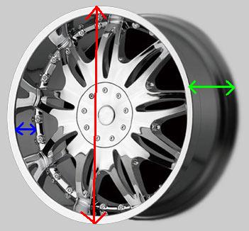

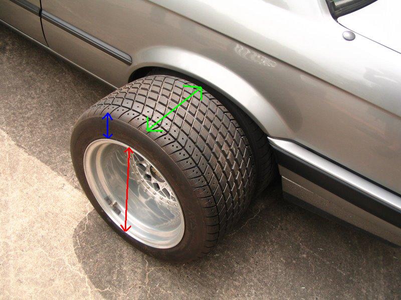

24/31 12.03.2008, 23:03
I made some pics again ^^
Easier for me to explain.
Lets take the first wheel combo to explain the values.
185/65R14 86H 5,5Jx14 ET44
The picture of the tire on the rim:
185 = green line, width
65 = blue line, height
R14 = red line, size of inner diameter and " of the rim
The picture of the rim without a tire:
5,5J = green line, width
14 = red line, " of the rim
ET = blue line
44 = value of the blue line
Do you come along with theese explainations? I could go more in detail, if it's needed.

26/31 12.03.2008, 23:45
xx_angel77_xx hat am 12.03.2008, 21:03:I made some pics again ^^
ET = blue line
205/45R16 7,5Jx16 is my combo. It's pretty common for the old modell of Carisma.
Hi and thanks for the pics and explanations! I understand it:P So you mean that I can buy a 205/ 45 R16 to my glx? And Thanks again for everything:P
