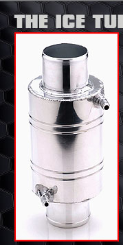

hab hier mal was für dich luftkühlung für saug und turbomotoren. das ganze wird dann an ein z.bsp. co2 kühlsystem angeschlossen und kühlt die durchstömende luft.
allerdings kost das ganze ca. 250 dollar plus ca 300+ für das co2 system.
The Ice Tube is a breakthrough air
cooling system for naturally aspirated
engines that uses S-Max Intercooler's
patented internal coil system technology.
Intake air travels through a 4" aluminum
tube that is wrapped around internally by
an aluminum coil. The coil is attached to
a cooling system like our CO2 kit. When
activated, the CO2 traveling through the
coil creates a freezing chamber inside
the Ice Tube, chilling the air just before
intake. The Ice Tube is available with
2.5" and 3.0" inlets to fit most
applications and measures 9 3/4" in
length. And although it is designed for
aspirated engines, it is also a great
complement for those looking to
supplement an intercooler in
turbocharged engines.

Hab jetzt auch was bei d&w gefunden was nen kompressor gleich kommen soll....weiß ja nicht ganz.
Hier ma nen link: http://www.duw.de/shop/DetailView.aspx? ... tId=259515
